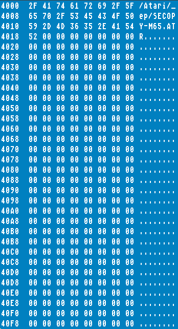

I did some minor first few tests and would like to let you know about things.
Command $DA is named "Get Device Slot Filename" which is not correct as the command returns the filename along with the path (without device). CMD_DA.png
Command $E0 does not work for me as it seems to return garbage. If I understand the description correctly I would expect a certain device slot's contents. Maybe I got wrong what should be returned. In that case please explain the command and data meaning. HOST_LIST.png CMD_E0.png
Command $FE does not return 33 bytes for the SSID but 32, so we get 96 bytes, the 97th being the checksum.

Hi Thom,
reading your comment about what I found out about command $E0 I am not sure if you are saying that the gibberish I got as a result is a correct answer or not.
Best, Erhard
It should be blank.
It's a good idea to run the FujiNet flasher, and to turn on the monitor, so you can see commands that go to the FujiNet and how it responds.
-Thom
Hello Thom, I think we are talking past each other. Originally I was talking about the fact that I wanted to change into a subdirectory from the Atari using the FujiNET Atari Tools (FCD). Then I tested (among other things) the SIO command $E0, because I thought it might have something to do with it. The command returns data that doesn't mean anything to me. Then you said that the command $E0 should return 256 * 0. I had assumed that the command should return the contents of a host slot, in my case #3, i.e. atari-apps.orata.online. But it obviously does not. What is this command for? Or is there only that one command for reading the host slots, which reads all 8 host slots at once and thus limits each host slot to 32 characters?
Of course I could run the flasher and try to log stuff, but I already know what was sent to the FujiNET and what data was returned. So I wouldn't see anything new, would I?
Best, Erhard
The reason I asked to use the flasher is, There may be a data point that we can debug.
If the host prefix is not set, then the returned value should be completely blank. If this indeed is happening, then some firmware debugging needs to happen.
-Thom

Yes, there is only command $f4 to get hostnames - and this returns all hostnames. So I suppose, hostnames can't be longer than 32 chars (or maybe 31 chars + string terminator $00).
"Host prefix" means only the prefix for all relative filepaths, i.e. the current directory. FCD sets this, and all file/directory commands use the current directory.
Dietrich schrieb: "Host prefix" means only the prefix for all relative filepaths, i.e. the current directory. FCD sets this, and all file/directory commands use the current directory.
I still do not understand what is meant. According to what you say it doesn't seem to be relatet to any of the 8 host or drive slots.
That's why I asked for an example, what to punch in, what it does on the FujiNet, what you see about it in the FujiNet menu, what it does according to your DOS prompt or whatever.
The Get Host and Set Host prefix commands were intended to be used by the FCD command.
Given a host slot, it sets the prefix for that host slot. This means that any path you put there would automatically get prepended to any host slot command (such as FLS or FMOUNT), so that you don't have to type the whole path when using FLS, FMOUNT, etc.
-Thom
it must be very difficult to provide an example ...
Are you saying that I can set a certain host slot to
a8stuff.somedomain.tld
for example?
If so I do not understand why the command supports 256 bytes of data regarding the fact, that a host slot entry can be no longer than 32 bytes.
deep-breath
because it's not meant to hold a hostname.
It's meant to hold a path.
e.g.
FCD 1,/Games/Action/Atari/
this would send a $E1 command to the fujinet with the string
"/Games/Action/Atari/"
so when you did an FLS 1,*
it would automatically prepend /Games/Action/Atari/ to the path to give
"/Games/Action/Atari/*"
or for FMOUNT:
FMOUNT 1,1,R,Defender.atr
It would actually use the filename:
"/Games/Action/Atari/Defender.atr"
This is why the buffer is 256 bytes long.

Now I guess I am beginning to understand ... I had tried something like "FCD 1,/Games/Action/Atari/" (using different but valid directory names) and then looked in FujiNet menu and didn't notice any change which confused me.
If I really understand things better now it is of course that nothing changed yet. Only if one mounts a file afterwards one would be able to see a change in menu or web UI.
